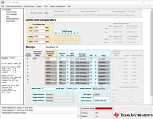

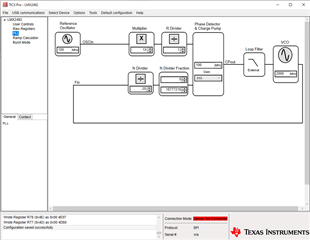

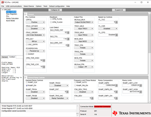

I can successfully set a single frequency of 2 GHz, 2.25 GHz, 2.5 GHz using the LMX 2492.
We can successfully ramp from 2 GHz to 2.1 GHz, but if we try to set the upper range for the ramp above 2.1 GHz then the ramp either refuses to start or goes haywire.
What could this be caused by?
