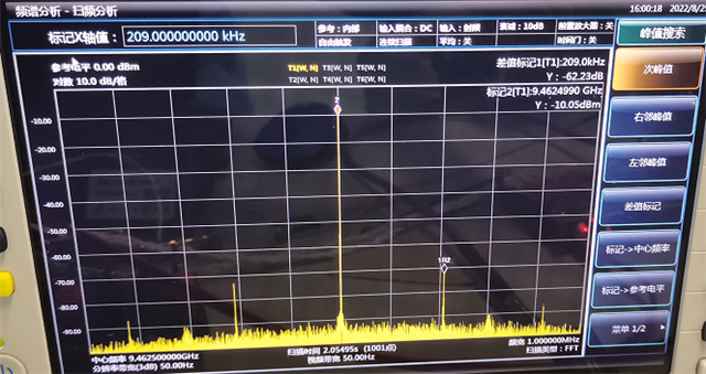

   I designed a product using LMX2694-EP.When the product works at +60℃.  RF output from the main frequency display spurt 200KHz. When the product works at +60℃.  But at slightly lower temperatures, the 200KHz spurious disappeared.  The output spectrum is shown below.  RF output from the main frequency display spurt 200KHz.
      1)Why spurious particles occur at high temperatures;
      2)How to eliminate it.
  • Hi Jiao,
    Can you share your software configuration and schematic?
  • Hi,Can you give me the email account? I will send the schematic to you.The software configuration is shown below.

  • Hi Jiao,
    I forgot to ask, what is your reference clock frequency?
  • Hi Jiao,
    The register configuration looks good, let's check your schematic offline.
