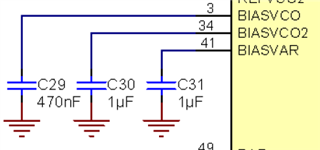

  • Hi Wada-san,
    I believe this is the error in the EVM, please change C31 to 10µF, this should improve the phase noise at these offset. The phase noise can be further optimized if we also change C29 to 680nF or 1µF.

    By the way  why could you find that C29,30,31 for "VCO" is not suitable ?
    I thought the reason for the phase noise degration was something about PFD.
  • Hi Wada-san,
    We found out similar phase noise issue with the incorrect capacitor values on the EVM. Please give it a try to see if you are actually having the same issue. If there is no improvement after the change, we can come back to investigate what may be the root cause. General speaking, with fpd = 100MHz, loop bandwidth is smaller than with fpd = 200MHz. As a result, in-band VCO noise will increase. Since the incorrect capacitor values will lead to higher VCO phase noise, so I guess you are having the same problem with these capacitors.

    I tried to change the capacitors to what you told me.
    The phase noise about 10kHz~100kHz was improved by that changes.
    On the Settings No.1 by changing C31 to 1uF the phasenoise at 30kHz offset was improved to -116dBc/Hz.
    Then on the Settings No.1 by changing C31 to 1uF and C29 to 0.68uF or 1uF the phasenoise at 30kHz offset was improved to -118dBc/Hz.
    Also on the Setting No.2  the phase noise was improved.
    I have recognized this problem has to do with the pushing of the VCO.
    Do you think my recognition is right?
  • Hi Wada-san,
    I think the noises could be coming from the internal LDOs. These LDOs need a bigger capacitor at their outputs in order to filter low frequency noises (<100kHz). So, yes, we could say that it is a frequency pushing issue.
