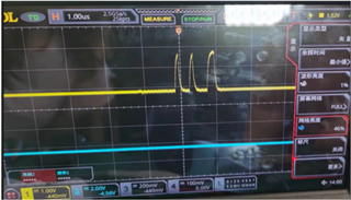

Using the lmx2592 chip to communicate with the Tinypico via SPI, the data waveform for sending data by viewing the oscilloscope waveform Tinypico is correct, and the waveform obtained from the lmx2592 Muxout pin by sending a reading command is correct, but whenever the Muxout pin is connected to the Tinypico chip miso pin, the Muxout pin level is pulled down below 1.8v. What do we need to pay attention to when using lmx2592's SPI output pins?
