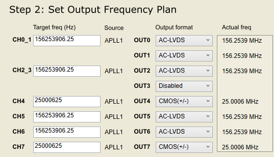

Hi Team,
My customer is using LMK05318B output need +25ppm drift.
CH0~2: 156.25MHz, LVDS => 156.254131MHz
CH3, 6: OFF
CH4: 25MHz, CMOS +25ppm  ==>25.000625MHz
CH5: 156.25MHz, LVPECL   ==> 156.254131MHz
CH7: 156.25MHz, CMOS  ==> 156.254131MHz
I have modify tcs file below, would you help to confirm below configuration? thanks.
 05318B_Frequency_091622.tcs
