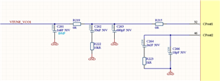

 The external loop filters can be found below

    What seems to not be locking your PLLs over time is your loop filter. From running a simulation, from the values you gave me, it seems that your phase margin is way too low (phase margin = 6.9 degrees), assuming your VCXO gain is 0.0025 MHz/V (TI standard for our EVMs) and you want to keep your loop bandwidth at 60Hz. If so, you should change your C263 = 2.2nF, C262 = 33 nF, R222 = 82 kΩ (phase margin will go up to 70 degrees). I obtained this values by using PLLatinum Sim, which you can download here. I have also attached a picture of my results from PLLatinum Sim below.
    If you would like more help from my end, please include in you reply your external VCXO's gain or data sheet and your desired loop BW.

  • Hi, thank you very much for your answer.
    We modify the filter components and now we have more consistency in our PCBs. So definitely this is related with the loop filter.
    We also found a method which works for all boards:
    - first we set PLL1 to work in open loop (forcing holdover mode) and we manually set VCPout1 to 1.65 V
    - We close the loop and PLL1 will lock.
