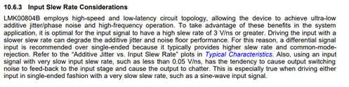

    1. Slew rate of 3V/ns is a datasheet recommended condition for optimal performance of the device. For your case the slew rate is about 0.2V/ns (assuming single ended sine wave)  which could cause chatter. There is no minimum slew rate specification in the datasheet but a generalization in below input slew rate consideration section.
    2. LMK00804B-Q1 would required higher slew rate as well as mentioned in the datasheet.

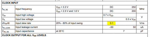

    I would suggest to use LMK1C1104 as an LVCMOS output fanout buffer. It has a minimum slew rate spec of 0.1V/ns.

    1. Recommendation for LMK1C1104 is due to 10MHz clock with 0.5V/ns slew rate. Since this part has a minimum slew rate spec of 0.1V/ns this would not cause any chatter or glitches on your buffer output than LMK00804B which causes problem at lower slew rates.

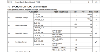

    - 7.7 Differential Input's as min 2V, max VDD + 0.3V
    - 7.8 as max 1.3V differential!! May this is for operations and requires any input attenuation's!!! Or may only if nClk switching too!

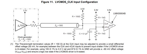

    As I use fixed nClk with additional 1K/1K & Cap as a reference and Clk as the AHC OXCO output and serial resistor.

    LMK1C1102/4 does have synchronous output disable and enable feature similar to LMK00804B. It also has minimum slew rate of 0.1V/ns values listed in electrical characteristics which makes it good contender to work with your conditions.
    LMK00804 would cause problem with slower slew rate because if you transition across the switching threshold slowly (i.e. with low slew rate), it takes longer for the internal signals to transition, and they become susceptible to amplitude modulation noise being converted to phase modulation.
    This is less true for differential inputs where common mode noise is rejected, but can still be a consideration.. but for single ended case its a big consideration.
    These conditions as you highlighted above are defined for  CLK_EN, CLK_SEL, LVCMOS_CLK pins.
    While using this as single ended this would required some attenuation and dc offset as suggested in termination section below.
