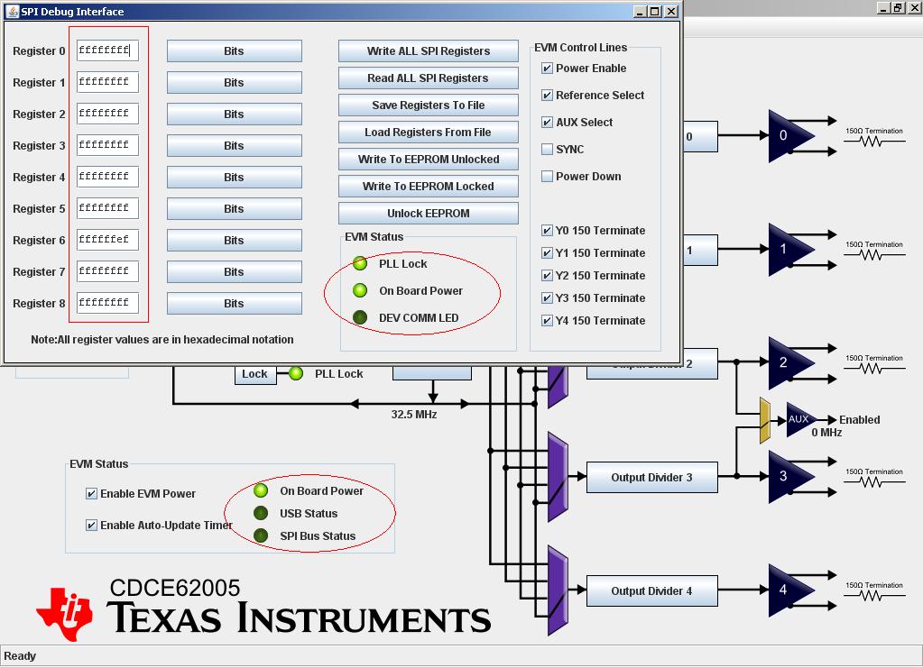

We are using CDCE62005 EVM for past 8 months for one of our application. It was working fine all these days and today we are facing a strange problem.
We are not able to communicate to the device using USB interface. As per the status window of the GUI, the DEV COMM has failed. Please note that we are using external reference clock at PRI and using external power supply. Please also note that the SPI register values are getting reset by itself to ffffffff. Even if we try to load the register settings via 'Load from File' option the register values are not being changed. During the faulty condition the EVM consumes a current of 615mA.
Please refer to the attached snap for further reference.
The register values used by us is also attached for reference.

  • Hi Anthony,
    When the USB status indicator is not illuminated and when the SPI read-back is ffffffff, this indicates that the PC is not able to communicate with the EVM - in this state it is not possible to change the device registers. If you are using a different PC or USB port on the same PC, it is possible that the device driver is not installed - can you try switching to a different USB port or another PC to see if this helps?
    There are a couple of other possibilities - if you are using a 64-bit operating system, the current driver released to the web will not support this, so we can send you a new driver to fix this. If the firmware on the EVM's USB controller has been overwritten for some reason, it might be necessary to rewrite the firmware. I can provide instructions on how to do this if this is the problem.
    Matt

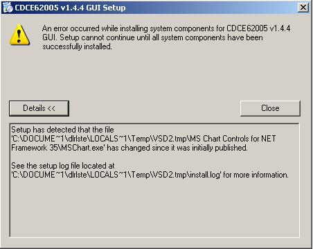

  • Hi Matt,
    Thank you providing the detailed procedure. I tried installing the CDCE utility in another PC and I could not succeeded. I am getting a .NET framework error. Let me know is this related to the OS (Win XP) or some driver update for CDCE. If you have the required .NET please provide the same.
    Thanks and Regards,
    Antony Baskar
