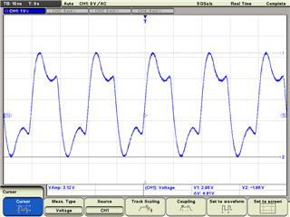

    2) We could not measure the current consumption of the device as a test point was not accessible. However the 50 MHz reference input into OSCin is as follows:
    With Vpk-pk of 4.91V. It is not clear from the datasheet if this level of excursion would cause a problem?

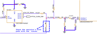

    A schematic of the arrangement is below:
    The LMK is driven by a Clock buffer (TI CDCV304TPWREP), and components labelled 'NF' are no fit.
    Please let me know if there is any other information I can provide to help debug this issue.
