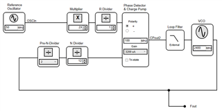

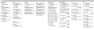

i am using the LMK04806 in dual loop mode and  single PLL internal VCO. the status_LD pin is low, and has the clk output but the output is instable. could you please help on this?

    I noticed three reasons why your PLL2 may not be locking. First off, in order for any PLL to lock, you have to choose a VCO frequency that's in between the ranges of the device (in this case, the internal VCO range is 2750 MHz to 3072 MHz). Since you picked a VCO frequency of 2400 MHz, that fell out of range, not locking your PLL. The other reason that your PLL2 is probably unlocked its because on the clock outputs page, for mode, you have it set for clock distribution in both the user controls and output tab instead of Dual PLL, internal VCO. I have attached my TICS Pro file with your use case (based on what I understood from your pictures) LMK04806_PLLUnlock_Dual.tcs
    In my file, you'll find I did not change the user controls from the default configuration. If you do need to change them feel free to do so, but do keep in mind if you are using CLKin0 and CLKin1, those 2 need to be enabled. If you would like more help, please include your .tcs file rather than pictures for me to better assist you.
