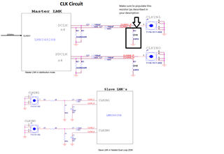

Hi  Timothy T
One question on the Sinewave at LMK Input Clock standards ( i.e LVPECL Single ended Output).
We have Master and Slave LMK scheme
The master LMK will supply the clock input to all of the slave LMKs in our system of multiple LMKs (Master and Slave LMK). Through a SMA Connector, the Master sends LVPECL Output while the Slave only receives Single Ended Clock IN.
Hence Only the P output of the LVPECL will be linked to the SMA Connector at the Master, and this single ended P Output sinewave will be connected to the Slave. The negative output of the LVPECL will be terminated with a 50 Ohm termination at the Master as shown in below figure,
Please confirm above scheme.
