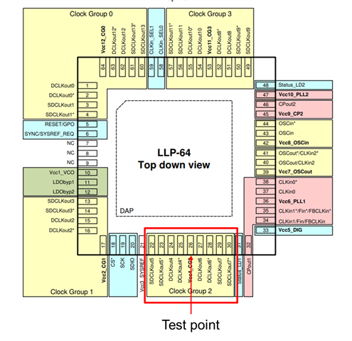

              In customer board, under normal temperature, there is no output of LMK04828 in Clock Group 2.
              After on-board testing, it was found that the impedance of VCC4_CG2 pin was 5.3ohm, which is abnormal, comparing with the 9.24ohm in normal one.
              Removed the abnormal chip and directly test at the VCC4_CG2 pin, impedance was 5.3ohm as well.
              Have we ever experienced similar failures?
  • Hi Adrian,
    Do they have measured the impedance at VCC4_CG2 pin without chip (after removing the abnormal chip)?
    If the pin shows the same impedance with 2 different parts, then there could be possibility of impedance issue at board.
    Can we able to get the schematic of the LMK04828 section?
