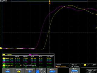

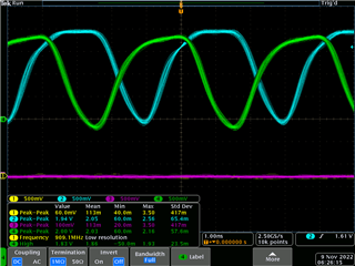

    I have probed the LMK04828 SYNC pins and seen the SYNC rising edge (left fig below). The right figure below is the DCLKout2 from the two LMK ICs.

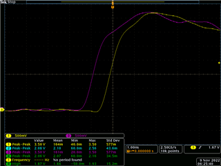

    I also have another "+1 VCO cycle error" probe results shown below.
    It seems that there is a 800ps difference of the two SYNC rising edges. But the difference is deterministic and constant between "+0 VCO cycle error" and "+1 VCO cycle error". Even though there is 800 ps difference of two SYNC signals, the deterministic difference will not lead to the two patterns of DCLKout2? Am I understanding correctly?
    For the register 0x143 bit 6 (SYNC_1SHOT_EN) of LMK04828, I set it to 0 (which means "SYNC is level sensitive and outputs are held in SYNC while SYNC is asserted"). How do we understand the level sensitive?
    Looking forward to your reply.

  • Hi Yilun,
    The output divider reset for multi device can be performed through external sync input at SYNC pin or CLKin0 pins. The input sync signal must be re-timed to the VCO cycle / distribution clock cycle for phased aligned reset. Hence the input sync signal should meet the setup time requirement. Also the delay in the sync input may not be exact same at the divider output, as it is re-timing with the clock cycle.
    But due to the CMOS variability in the SYNC pin path, there is 3-5ns uncertainty in the sync pin timing, which makes SYNCing output dividers through SYNC pin almost impossible at 1GHz clock input, whose clock cycle period 1ns. that's will provide the multiple VCO cycle error.
    Whereas the sync through CLKin0 input pin has precise setup timing (≤ 150ps) and should be possible phase aligned divider reset. but need to have rising edge aligned synced inputs to multiple devices.
    Thanks!
    Ajeet Pal

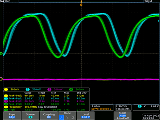

  • Hi Ajeet,
    I tried performing external sync at CLKin0 pins. It seems that I got more output patterns of DCLKout2 (more than ±1 VCO cycle error).
    The sync toggling was sent through "lbreg.lmksync", which was connected to differential FPGA pins with OBUFDS.
    assign hw.fmc1.lmk_clkin0=lbreg.lmksync;
    assign hw.fmc2.lmk_clkin0=lbreg.lmksync;
    Then the FPGA pins were directly connected to LMK CLKin0(*) pins.

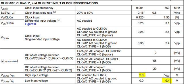

  • Hi Yilun,
    For external SYNC at CLKin0 (precise setup timing), the input signal should be DC coupled differential and should meet the digital logic level for resetting the dividers.
    Register config looks good and seems HW setup need to be updated for SYNC as well as SYNC input to both devices should be aligned.
    Thanks!
    Ajeet Pal
  • Hi Ajeet,
    The CLKin0 pin is connected to the FPGA pins directly, which is LVCOMS18 I/O standard (1.8V). It seems that it doesn't meet the V_CLKin0 high input voltage requirement (>2.0V). Unfortunately, this HW setup can not be updated immediately on the current board.
    Shall we try other solutions? The flexibility from my side is the external clock on CLKin1 port. If we use 100 MHz input clock, can we use the SYNC pin to synchronize device clock output from multiple LMKs? The device clocks to be generated on my board are DCLKout2 (250MHz), DCLKout4 (1GHz), DCLKout8 (500MHz), and DCLKout10 (125MHz).
    Thanks and best,
    Yilun
  • Hi Yilun,
    My apologies in the error in above response.
    The CLKin0 differential input needed in bipolar type and DC coupled mode.
    If the change in HW setup is critical, I would suggest to try in 0-delay nested dual PLL mode to achieve the deterministic skew between multiple-device sync.
    Thanks!
    Ajeet Pal
