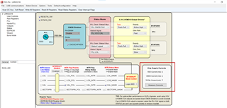

  • Hi JH,
    When I load their config on my EVM I see around 63-64 mA of current being drawn or
    P=V * I = 3.3 V * 64 mA = 211.2 mW
    Vicente
