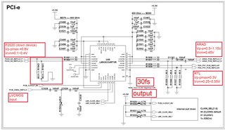

My customer is designing the LMK00334.
Please review the customer's design below.
Thank you.

  • Hi JH,
    Schematic is good and following all the guidelines. Please make sure to include these inputs as well.

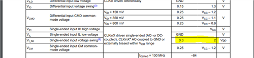

    • Make sure that the LVCMOS input is following  the datasheet single ended input requirements.
    • 33 ohm is series usually help with overshoot but not necessarily required in this case.
    Other than above inputs, I don't think there is an issue with the schematic.
