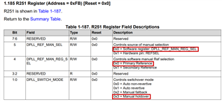

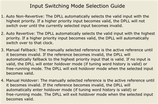

I am using LMK device, I am feeding only PRIREF to this device. SECREF input is unconnected.
If I disable PRIREF input then I expect the device to go to hold-over mode, But instead I see it is switching to SECREF. How I can resolve this problem?
