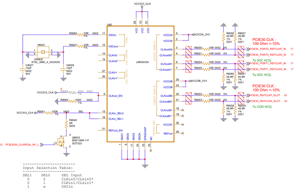

Hi Sir,
Would you please help review below schematic?
If any need modify or notification, please let me know.

Hi Jeff,
Schematic looks okay with proper terminations. I have one question about the Q8003. Do you plan to turn off clock using this? because if you are using XTAL then CLKin_SEL can be tied to VCC permanently.
