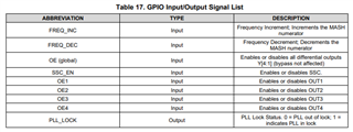

Enable (OE) : High" but "Individual Output Enable(OE1~OE4): Low" cases, I want to know whether OUTx pin output clock or not?  Please advise us.
Thanks and best regards,
M.HATTORI.
    On "Global Output Enable (OE) : High" but "Individual Output Enable(OE1~OE4): Low" cases, I want to know whether OUTx pins output clock or not.  Please advise us.
    M.HATTORI.

  • Vicente-san,
    I want to confirm the following.  Please let us know.
    *1.
    In my understanding,
    "Output clock" is only the following condition.
    GPIO as Global Output Enable (OE) =HIGH, GPIO as Individual Output Enable (OE1-OE4) =HIGH
    Other following cases are "Disable Clock".
    GPIO as Global Output Enable (OE) =HIGH, GPIO as Individual Output Enable (OE1-OE4) =LOW
    GPIO as Global Output Enable (OE) =LOW, GPIO as Individual Output Enable (OE1-OE4) =HIGH or LOW
    Is it correct?  Please advise us.

  • Vicente-san,
    My customer sets the following,  As your comments, Output is disable, but CDCE6214 outputs clock.
    • GPIO1 : Assign OE3   ->  External pull-down (Low)
    • GPIO4 : Assign Global OE   ->   External pull-up (High)
    Are there any other setting to output disable/enable?
    Please advise us.
    M.HATTORI
  • Hi Motoyasu,
    In this case since global OE is pulled high, this will still result in output clocks.
    No, there are not any more settings to enable/disable.
    Vicente

    Again, could you please let us know the following cases?
    GPIO as Global Output Enable (OE) =HIGH, GPIO as Individual Output Enable (OE1-OE4) =HIGH  ->  Enable Output
    GPIO as Global Output Enable (OE) =HIGH, GPIO as Individual Output Enable (OE1-OE4) =LOW  ->  ??
    GPIO as Global Output Enable (OE) =LOW, GPIO as Individual Output Enable (OE1-OE4) =HIGH  ->  ??
    GPIO as Global Output Enable (OE) =LOW, GPIO as Individual Output Enable (OE1-OE4) =LOW  ->  Disable
    Please advise us.
    M.HATTORI.
  • Hello Motoyasu,
    Based on p. 28 of the data sheet and p. 30 on Table 17, if OE = HIGH, then it enables all differential outputs after 4 internal clock cycles. However, if any of the Individual Output Enable (OE1 - OE4) = LOW, then the output for that channel should be disabled.
    Therefore,
    This one should be LOW for the OEX = LOW (so if all 4 OEX are LOW then all outputs will be disabled).
    This one should be HIGHfor the OEX = HIGH (so if all 4 OEX are HIGH then all outputs will be enabled). Hope this helps!

    I am a little confusing.  My customer wants all-output-clock after power-up.  On this case, the following pins are also "external pull-up".  Is it correct?  Please let us know.
    • Global OE (GPIO4) : Pull-up
    • Output Enable 3 (OE3) (GPIO1) : Pull-up
    He can not change the internal initialization data on CDCE6214.
    M.HATTORI.

  • Hello Motoyasu,
    That is correct. When the GPIO3/4 pins are set to input (which is the default), there is a weak pull-up resistor of 50 kΩ. Hope this helps.
