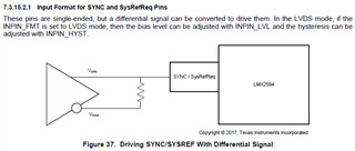

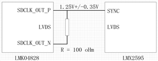

The datasheetl provides a connection diagram of Driving SYNC With Differential Signal as shown in the figure below. In actual use, we will use LMK04828 to
output LVDS format SYNC to synchronize multiple LMX2595 chips. Is the connection diagram below correct? Is the resistance value appropriate? Is there
anything else that needs attention?
