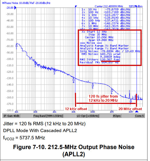

  • Hi Charlie,
    The LMK5B12204 can function as a jitter cleaner (primarily in the 12 kHz to 20 MHz integration range). The DPLL can be used to attenuate the close-in phase noise, which is around less than 1 kHz. Otherwise, the device can be used in free-run or clock generator mode where the DPLL is disabled and only APLL1 and APLL2 are used. The better jitter performance in the 12 kHz to 20 MHz range comes from the BAW VCO which is 2.5 GHz. To get your list of frequencies, APLL2 is required which has a range of 5500 - 6250 MHz. I recommend cascading APLL1 output to APLL2 input for improved jitter performance.
    Please provide your phase noise and jitter requirements and I can check if this device will met your specification.
    Jennifer

  • Hi Charlie,
    1. No, jitter integration range is different from frequency output or VCO frequency range. I've attached a sample phase noise plot which showcases the area in which the jitter is calculated. For an output of 212.50 MHz, the jitter of 120 fs was attained by integrating the noise from 12 kHz to 20 MHz offsets.
      1. Please provide the desired jitter integration range for me to confirm the LMK5B12204 meets your spec. 12 kHz to 20 MHz is a common range.
    2. Yes, it is possible to generate those outputs clocks with such accuracy.
    Jennifer
