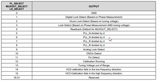

LD_SELECT can be values from 0 to 15. For number 4, READBACK, you have to clock out the bits for the register you are reading. It appears other bits are just a single logic output such as for LD_SELECT values of  1, 2, or 3 that are the lock det functions. For logic detection functions I assume these outputs change with the state of the phase lock and once setup don't require further programming in the synth. These then just become a logic output that can be read by a processor. For values of LD_SELECT from 5 through 15, what is the format of the output in those cases? I assume 5 through 8 have to be clocked out to read a number while 9 through 15 are a simple logic output? Can you share what the format of each of these will be?

    I believe you are misunderstanding how to use the LD_SELECT pin.
    Basically, for register R7[12:8] (which determines LD_SELECT), you write the binary number for the LD_SELECT pin to behave in a specific way/output a state of the LMX2581. For instance, when looking at the table below, if you would want to divide the PLL_N value by two, you would set R7[12:8] = 00101 (or 5 in decimal/the first column on the table). This state could lead for the LMX2581 PLL_N to be half of its previous value. So, to directly answer your question, I don't believe a number would be outputted, but instead the PLL_N would change value.
    However, as you also stated above, you can program the LD_SELECT pin to just track and output a behavior of the LMX2581. For instance, if you would want to know if the calibration is running, you would set R7[12:8] = 01100 and the LD_SELECT pin would output a state rather than change something within the part (as demonstrated in the previous example)
    Correct! Once you set up the LD_SELECT bits to "watch" a specific type of lock detect, the LMX2581 will demonstrate lock based on what you set the LD_SELECT pin to track.

  • Thanks for the clarification that the PLL_N settings apply that function directly to the dividers. So, the only readback of data is when LD_SELECT = 4, everything else uses the LD output as simple logic? What is the Analog Lock Detect when LD_SELECT = 9? I don't see any writeup in the data sheet for this. How does this differ from LD_SELECT 1, 2, or 3?

  • Hello Charles,
    The only readback is when LD_SELECT = 4 based on the table I attached previously, that is correct. Regarding everything else being simple logic output, as  when dealing with settings 5-8 a change to PLL_N or PLL_R values won't return a simple logic, but change the values of the PLL. If you also define that behavior as simple logic, then yes, you are correct.
    In summary, analog lock detect outputs narrow pulses when the phase detector is on, but do note that digital lock detect tends to be preferred to determine if the PLL is locked. For a more detailed explanation please refer to this E2E post.
    Digital lock detect (also explained in E2E post referenced above) outputs a high or low letting you know whether the PLL is locked or unlocked. Vtune lock detect looks at the tuning voltage, if Vtune = Vcc/2, then the PLL is considered to be locked . Finally, lock detect considers both of this. Hope this helps.
