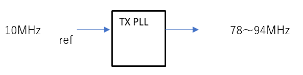

My customer is struggling with the TX spur of LMX2571.
The ref LO has ~80dBc spur at 10MHz +/- 80kHz.
Looking at the PLL output (f0=78MHz – 94MHz), the f0+/- 80kHz spur increases to 60dBC (+20dBC).
The spur level changes every time setting R0 register.
It changes to 60dBC or 70dBC randomly.
  1. Could you let me know the possible reason that the LO spur level increases with PLL?
  1. What is the possible cause of the spur level change with the R0 register setting?
