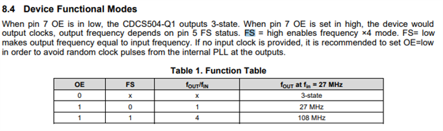

And here is one more question, please advice about the setting of FS and OE pin considering internal pull-up.

  • Hello Chase,
    It seems that the customer is floating the FS nd OE pins, may I ask why? Depending on the operation they want, I would recommend to not float both pins. Instead, please follow the guidelines and table below from p. 7 of data sheet. Also, based on the previous section I sent, it seems that when using a TAS6424, you set the device to x1 mode when a 32 MHz frequency is desired and x4 mode when a 27 MHz frequency is desired. Hope this helps!
    Good luck,
    Andrea
