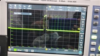

We have a LMK04828 based board, we are trying to achieve SYSREF Pulser at SYSREF Distribution path,
Case1:
  • CLKIN0- 5MHz External Signal, 100MHz VCXO at OSCIN, SYSREF_MUX is set to SYSREF_Pulser (CLKIN0)
We observe strange output at SYSREF Distribution path below is attached image of Captured waveform of SYSREF and Configuration files:
  • Multiple SYSREF and is non periodic output
  • SYSREF_Pulser count is 2 and We have tried checking SYSREF_PD set still we observe the same.
  • We observe proper SYSREF when SYSREF_MUX is set to SYSREF Continuous but not on Pulser mode
  • We are not using SYNC Path.

Please let us know, anything we are missing here.
Case2: We have observed the same thing with no input at CLKIN0 i.e. CLKIN0 is left open and with SYSREF_MUX set to SYSREF_Pulser.
    The SYSREF Pulser can be operate by external SYNC pin or SPI controlled (SYNC_MODE) and "SYSREF_MUX" needs to be "SYSREF_Pulser" mode
    Also the SYSREF_PLSR_PD bit should be low.
    In the current configuration, CLKin0 input re-clocking with SYSREF frequency and it continuously latching the SYSREF output.

  • Hi Ajeet,
    Thanks for your response
    I apologise for presenting the issue to you incorrectly.
    We want to use our LMK04828 in reclocked mode, and the SYSREF to clkin0 is coming from outside.
    We want to reclock and send the incoming SYSREF through the SYSREF distribution mux.
    Based on our application, we want to send SYSREF as a pulsed and continuous signal via clKIN0.
    The issue is:
    When we configure the LMK in reclocked mode and do not feed any external input to CLKIn0, we see the PULSED waveform shown in the image.
    We shouldn't be getting anything because we're not feeding anything to clKin0.
    It seems, the both PLLs in dual PLL mode are locking with 0-delay mode and getting some SYSREF issue.
    Here, I have attached the latest config file. Please update the outputs based on requirement and see the re-clocked SYSREF performance.

  • Hi ajeeth,
    Thanks for your configuration file
    we have tried bypassing vcxo and feeding clkin1 from external LMK
    We are using a giving SYSREF (pulsed or continuous) from an external LMK in this instance.
    At every SDClkouts output, we are seeing the same thing that is depicted in the image.
    pulse sysref is used for resting the NCO of multiple DACs which is creating a problem for us.
    request you to assist us in resolving the problem.
    This setup would required to meet the precise setup and hold timing. What is the CLKin1 frequency used in this configuration? If it is too high, then CLKin0 input delay need to adjusted enough to meet setup and hold timing.
    Otherwise, generate the SYSREF in secondary LMK and keep the CLKin0 reclocked with SYSREF frequency, it will have sufficient margin and should be improve the pulsed reclocked SYSREF outputs.
    Thanks!
    Ajeet Pal
  • We noticed that the CLKIN0 input type was set to BIPOLAR for a sinewave input; changing it to MOS corrected the problem.
