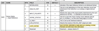

    lmh1983 shows LOST_HSYNC when NG.
    Reg 0x00=0xC6
    What the meaning of the description?
    I didn't find HSYNC_MISSING  and no_h_during_v.
    HSYNC_MISSING = LOST_HSYNC?
    Set if HSYNC_MISSING is high wile no_h_during_v is low. Remains set until read, then self-clears
    On the other hand, the device status of Addr:0x01 Holdover=Low, Lock_Status=High seems to maintain Genlock.

  • Hi ttd,
    Unfortunately, I cannot find the definition of these description. Sorry that we cannot help.
