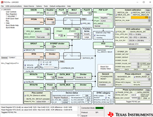

LMX2820: phase is not deterministic after giving SYNC pulse continuously
Part Number: LMX2820
Other Parts Discussed in Thread: LMK04832
Hi Ti Team,
We are using LMX2820 in category 3 and observed phase synchronization for some frequencies(Example frequency is 1001MHz, 3030MHz,9044MHz) but not for all (Example frequency is 2464MHz) if we give phase sync pulse continuously. observed 180 shift.
What Could be the reason and how to resolve it?
Testing Configuration: VCO full assist calibration (forced the VCO values) and Sync pulse is coming from LMK04832. Reference frequency =100MHz coming from LMK.
Your inputs are highly appreciated
