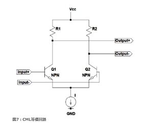

Is RFOUTAP/RFOUTAM an internal circuit like "CML"?

    OSCin input requires AC-couple, so the DC content of the input signal is not important. The voltage swing of PSEL is 0.8V, which is good enough for LMX2594.
    I do not have the exact circuit diagram but I think it is pretty much like the diagram you shown with R1 and R2 being external.

  • Hi Wada-san,
    Signal format is not matter, as long as the voltage swing meets LMX2594 requirement, it will work.
    If you going to input the clock signal differentially (connect both OSCinP and OSCinM pins), the voltage swing (Voscin) requirement is 0.1V to 1V.
