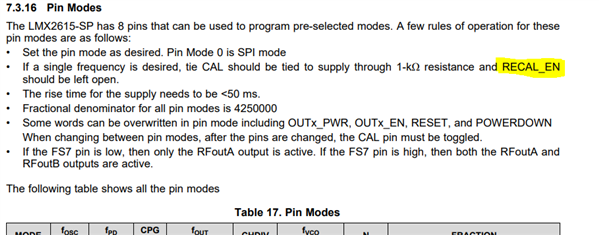

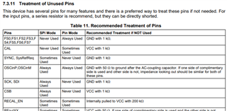

Hi all,
In the datasheet it is stated that RECAL_EN is pulled to VCC with 200 kohm internally. We would like to use this feature in our application (radiation is a concern for us) so what is the recommended connection for RECAL (Pin 45)? Left open or Vcc with any resistor?
Mehmet
