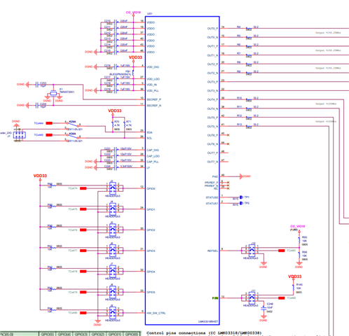

LMK03318: LMK03318 ROM mode setting
Part Number: LMK03318
HI,
   This is related to prev case CS1525439
1. For ROM mode, the GPIO[5:0] = 24d = 0b011000, what is the value for REFSEL (2state)?  The document stated REFSEL Vim =0.9V for SEFREF selection for 3state. How about 2 state ?
    I am using a XO connected to SECREF.
  • SECREF_P/N = 50MHz XO(7M50072001))
  • GPIO5 = Low
  • GPIO4 = High
  • GPIO3 = High
  • GPIO2 = Low
  • GPIO1 = Low
  • GPIO0 = Low
  • HW_SW_CTRL = High
  • REFSEL = 0.9V ??  (Input mid voltage for the 3-level logic, this selects the secondary clock as the PLL preference)

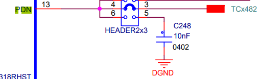

  • PDN - connected to gnd via a 10nF

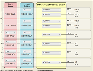

2.  Can u verify if the above setting connection below can work when pwr on ?  Expect when power on, auto generate diff clk output (OUTPUT0,1,2,3 = 156.25Mhz, LVDS, OUTPUT4,5 = 100MHz, LVDS).  Any additional setting needed ?
rdgs
stloh
