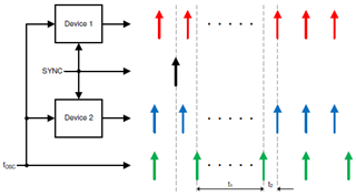

Which phase in the input path from OSCin is used as a deterministic anchor to the RFout phase when using the SYNC pin? Is it the phase of the signal on the actual OSCin pins or somewhere on the doubler/divider/multiplier chain?
Thanks in advance for your reply.
