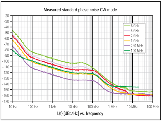

Could you provide me with the best LMX2594 settings and register values to satisfy the target performance for the given conditions?
Target performance
  • Phase noise at RFoutA (6210 MHz)
    • -95 dBc/Hz or less at offset frequency of 10 kHz
    • -107 dBc/Hz or less at offset frequency of 100 kHz
    • -120 dBc/Hz or less at offset frequency of 1 MHz
    • -145 dBc/Hz or less at offset frequency of 10 MHz
Conditions
  • OSCin frequency: around 250 MHz (adjustable)
    • Phase noise characteristics of the input signal
  • fPD: Any frequency is acceptable
  • RFoutA frequency: 6210 MHz (fixed)
  • Phase margin: around 60° or more (target)
  • Loop bandwidth: around 200 to 300 kHz (target)
  • Loop filter: 2nd order
  • ICPout: 15 mA
