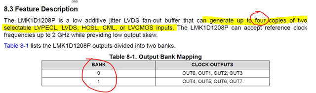

For the OEx pins. The datasheet states that the default is high – does this mean that for any inputs that I’ll always keep on, I can leave this pin floating? Or do I need to externally tie it high?
Secondly, I noticed the datasheet section 8.3 indicates that 4 copies of the input can be generated - shouldn't that be 8 copies of either input with the output level configurable per BANK?

    OEx have an internal pull resistor so by default outputs are enabled. You can leave the pins floating and it should enable your outputs. I think its good practice to tie them to VCC or GND instead of floating to avoid any noise coupling and causing a false state.
    This is a typo here, we will update datasheet with correct description.
