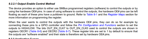

    CDCDB800 supports both SMBUS and OE pin control. You can use each of them individually or combined. Section 9.2.2.1 of datasheet explain how they function in each mode.

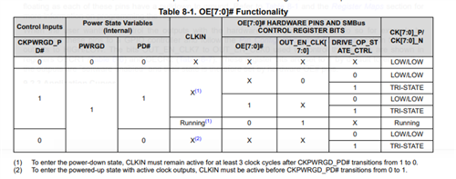

    Table 8.1 explains different all pins and register combinations for clock outputs.
    what is the priority for OE control and SMBUS control?
    SMBUS and OE have a AND function between two control types so both are needed in certain conditions for other to operate as mentioned in the table.
    if we make pin46 floating(SMBUS enable status), could OE# control be active? or must disable pin46.
    Pin 46 is for SMBUS write lock. So if you have that pin floating then OE# control would still work because default values for registers are set to 1.
    if we don't use OE# control, want to use SMBUS control instead, how to connect OE#, disable or enable?
    You can leave them floating or tie through a pull down to ground. External pull down option is good when there is possibility of noise getting coupled to OE# pins.
    actually, customer want to use SMBUS and OE pin control function, so need a compatible BOM connection. thanks.
    You can connect output through a jumper to VDD or GND or a GPIO pin for controlling pins. Pin 46 can be left  floating but it you are concerned that noise can get coupled on this pin and cause a WRITELOCK then its better to tie it to GND externally.
