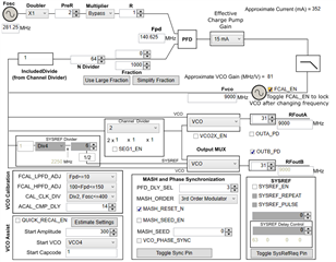

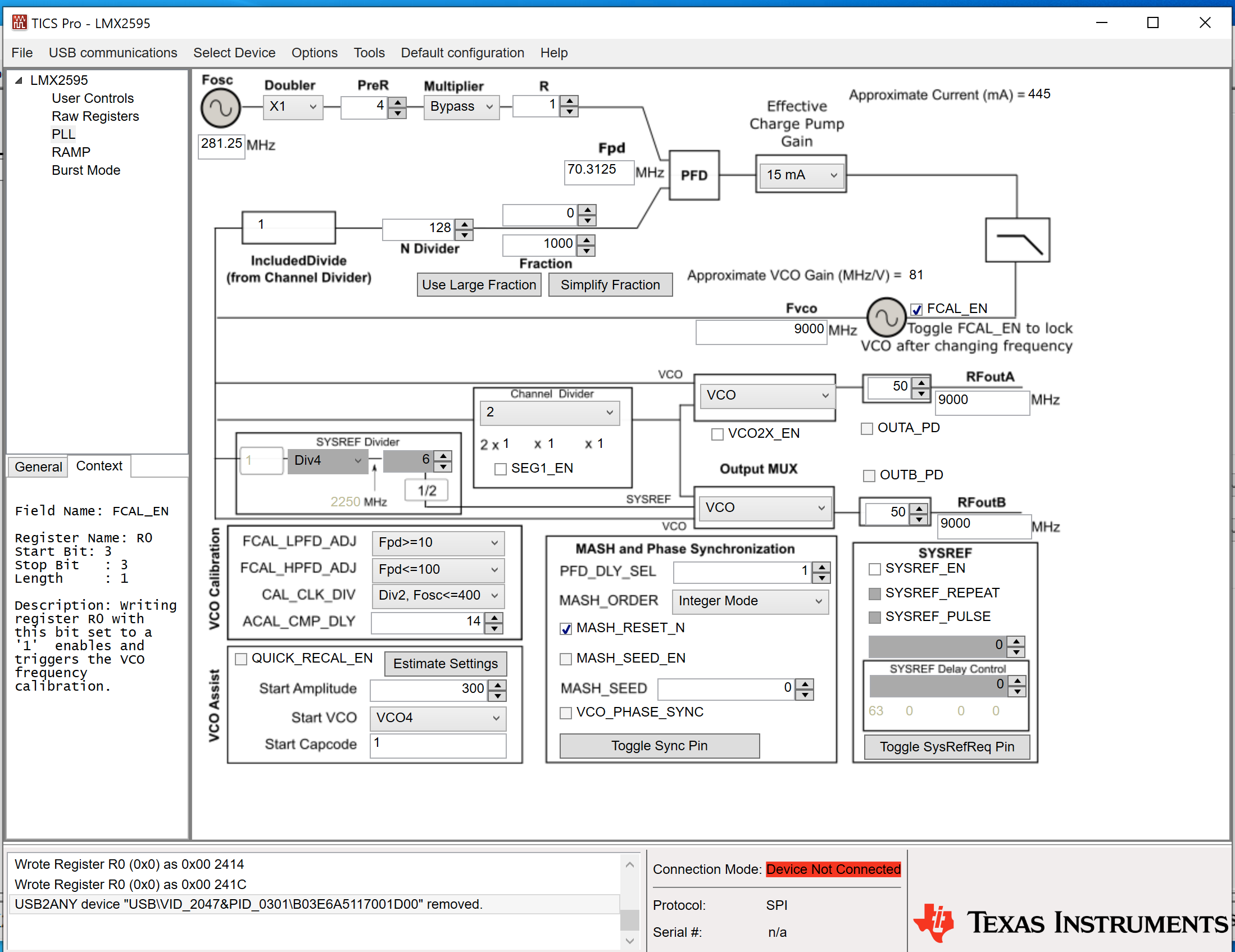

    Could you provide the PLL configuration in TICS Pro format? For example:

    Thank you for looking at this, I'm asking the FPGA designer to provide the PLL configuration in TICS Pro format.

  • Hi David,
    The configuration looks good, so the only reason that will make the VCO jumping is the reference clock is jumping.
