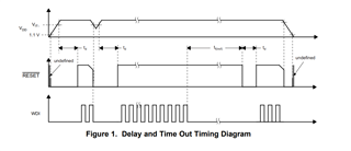

I designed system using 28388D. I need 5ms time out watchdog ic.
Can you recommend?
Do you have it?
thank you.
(IC that resets when no pulse comes within 5 ms[Tt(out)] )

Actually, I used TPS3820-33 IC.
cause of watchdog time out 200ms is too long, That why I ask you recommend 5ms watchdog ic.
