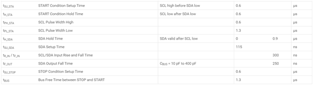

Hello, support team.
I have a question.
Whad do you mean min of I2C Clock Rate is 100kHz and max. is 400kHz?
Refer see below LMK03318 datasheet, please.
https://www.ti.com/document-viewer/LMK03318/datasheet/i2c-compatible-interface-characteristics-sda-scl-snas6699065#SNAS6699065
This is NXP Semiconductors's official I2C specification.
UM10204 I2C-bus specification and user manual
In this I2C specification, it says below definition.
Standard-mode (Sm), with a bit rate up to 100 kbit/s
Fast-mode (Fm), with a bit rate up to 400 kbit/s
Do you mean LMK03318 can use Standard-mode or Fast-mode?
Concretely speaking, is the clock rate 99kHz OK or NG?
If 99kHz is NG, I use the I2C Clock Rate should be 100kHz over, for example 110kHz.
