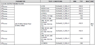

  • Do you know the additive jitter from OSCin to OSCout? I cannot fnd it in the spec.
  • Hi Christian,
    OSCout and CLKout buffer has the same performance, their noise floor is identical.
    So, the additive jitter is going to be very low. In fact, the additive jitter from OSCout would only affect the phase noise of the 100MHz signal a little bit at the far out offset which is not important to LMX2595. Far out offset phase noise of LMX2595 is determined by the VCO and RFout buffer noise floor.
