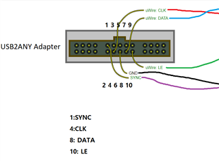

  • Hi Olive,
    There should be a way to use jumper cables to connect the uWire pins directly into a USB2ANY adapter, I am sorting out the details. Do you have a USB2ANY adapter/module (https://www.ti.com/tool/USB2ANY) available? It is not sold with the EVM.
    Evan Su

  • Hi Haeyong,
    Good to know that you have a USB2ANY adapter. You will need to use jumper wires to connect the CLK, DATA, LE, GND, and SYNC lines from the uWire interface into the corresponding leads of the USB2ANY. I am trying to figure out the identities of the leads on the uWire header and will let you know when I do. Alternatively if you have a method of connecting wires to the test points, those could be used instead of the headers.
    Evan Su
  • Hi Haeyong,
    After studying the schematics and PCB layout I believe the correct wiring solution is as follows:
    Try it out and let me know if you are able to successfully use the USB2ANY.
    Evan Su

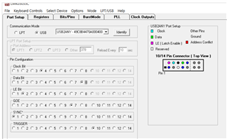

  • Thank you for your help. Here is my results.
    1.  First I tried to connect using CodeLoader as described in as LMK03000C/01C/02C/33C Evaluation Board User's Guide (Rev. A).
    Then I tried to set "Port setup" in CodeLoader as follows.
    But in the port setup, I could not connect "LE" to "10"( 10 is disabled)
    2. Using TICsPro, I can connect board successfully.
    Thanks again.
    HaeYoung
