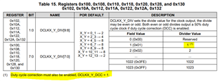

We are trying use this device as single loop PLL2 mode and distribution mode with CLKin1 as REF IN.
Only use CLKout0/1, CLKout2/3, CLKout4/5 and CLKout6/7 for now.
1. single PLL2 mode with CLKin1
PLL2 is locked and DEVICE CLK outputs are fine. However there are no SYSREF outputs (see attached register dump)
2.  distribution mode with CLKin1
Both clock and sysref output frequencies are fine, 100MHz and 0.1953125MHz (sysref) when CLKin1 is 400MHz
However the frequencies are not right when CLKin1 is 100MHz.
Here are the interesting things,
1) both clock and sysref frequency are divided by 4 if just changing the CLKin1 Freq and other settings are stay so that it seems OK
2) If the clock output Freq is set to 100MHz (the same as CLKin1, the actual Freq measured is 33.333MHz.
