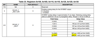

Hi Team,
From the datasheet, it seems that delay value determined by field value as below equation.
Delay value = 125 + 21 * Field value
However, it does not match as datasheet. Can you please check if the datasheet is right or not?
Field value Delay value
0 125
1 146
2 167
3 188
4 209
5 230
6 251
7 272
8 293
9 314
10 335
11 356
12 377
13 398
14 419
15 440
16 461
17 482
18 503
19 524
20 545
21 566
22 587
23 608
Austin
  • Hi Austin,
    SCLKX_Y _ADLY field is 5bit and it can go up to 0x17 (23) values for 608ps delay, as you mentioned above correctly.
    I can take this as an datasheet update input and will make the update in next revision.
    Thanks!
    Ajeet Pal
