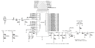

LMK04828: Jitter spec
Part Number: LMK04828

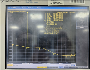

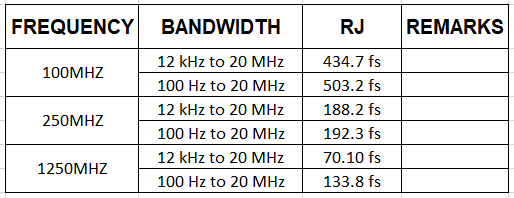

The following clock generator (Part#: LMK04828BISQ)is used in one of our application.100MHz clock is derived for DUT.
Observation:
It is observed that the random jitter is around 700fs in our board. However, the datasheet states that "88fs RMS jitter for 12KHz to 20MHz & 91fs RMS jitter for 100Hz to 20MHz.
Schematic and Register setting details are attached.
Please review the schematic and register setting details and let us know your suggestions to reduce the jitter in our design.

    1. Since external oscillator has been connected with Oscin pin of clock gen, we understand that single loop has been implemented in our design. Therefore, PLL1 has not been used. Please review our schematic and confirm it.
    2. Random Jitter measurement has been taken with various frequency (from lower frequency to higher frequency). Rj is higher at lower frequencies and lower at higher frequencies (Ex: 192fs @ 250MHz, 133fs @ 1250MHz). Rj is getting increased while "N" of PLL2 getting increased.
    Dhanasekaran.V
  • Hi Dhanasekaran,
    I looked at your schematic and it appeared to line up with the single loop mode. To be sure I would need to check the full device configuration. I reviewed the .log file you provided but I am not familiar with the format and could not find some of the registers I was looking for such as OSCin_PD. Did you use our TICS Pro software to generate the register configuration? If so, please provide us with an exported configuration file (.tcs), it will help us review the situation more quickly.
    Our expert seems to have been busy yesterday but I hope he will be able to get back to you soon.

  • Hi Dhanasekaran,
    Are you performing the test with on-board VCXO (U7) or external input at OSCIN_N pin?
    If it is through U7, C279 should be DNI and OSCIN_N pin connect to GND through C280.
    If the reference is external at OSCIN_N pin, U7 should be power down, which can introduce lot of spurs on the output and you would see worst jitter number. Also you need to keep C353 as 0.1uF, C352 as DNI and R227 replace with 0ohm resistor.
    To use in the dual PLL loop, you need to have external input at CLKin0/1/2 input pins for the PLL1. But there is no input pins are connected to any connector for external input. Hence, it can't be configure in dual PLL mode.
    Thanks!

  • Dear Ajeet Pal,
    We have done few test cases to measure the Jitter level in the LMK04828 Evaluation board designed by TI. The test reports are attached.
    Observation:
    1. The datasheet states that 88fs RMS Jitter (12KHz to 20MHz) & 91fs RMS Jitter (100Hz to 20 MHz). However, we are observing more than the datasheet spec.  Please clarify the test condition at which TI observed 88fs & 91fs.
    2. Jitter value is high at low frequencies and low at the high frequencies. It shows that jitter is getting varied based on the divider value. Please clarify it.
    3. Is any correlation between Input OCSInp, Internal VCO0 or VCO1, Divider value used to configure the desired clock out at the DCKOUTxP&N with minimal jitter.
    4. The datasheet states that Jitter would be optimized for the dual loop mode. However, we did not notice much difference between single loop and dual loop. Please clarify.
    5. We would like to generate 100MHz (Differential) clock out with 50MHz & 100MHz clockin with dual mode & single mode. Please provide the setting for this condition.
    6. Do you have jitter spec for 100MHz diff clock out?.
    Thank you
    Dhanasekaran.V
  • Hi Dhanasekaran,
    What are the configuration used for phase noise testing? Please share the used configuration file.
    You can use the default configuration "CLKin1 122.88MHz, OSCin 122.88MHz" available in TICS pro and set the CLKout0/2 port for required frequency. also make SYNC_DISx --> "1". It should give  the optimized phase noise measured data.
    The jitter numbers at lower output frequencies are not coming true. At higher divider values, there is less change at far off noise, hence it may increase the total jitter, which can  be in the range of ~100-120fsec even at divider value 32. May be you can look on the measurement setup.
    Yes, with the higher phase detector frequency, the N-divider would be less and improve the overall flat noise performance and have optimized/improved jitter.
    The dual loop mode operates as jitter cleaner, where input at the PLL1 may be noisy and using the optimized PLL1 setting and used VCXO, the over all jitter performance can be improved. In your case, PLL1 may be already with optimized phase detector frequency and loop filter BW and the PLL2 output would see the VCXO performance at close-in offset in both the cases. Hence, it shows the almost came performance.
    LMK04828EVM has the on-board VCXO frequency 122.88MHz. Hence we could not have  the optimized phase noise number for 100MHz output, which would required the integer multiple of VCXO frequency for higher phase detector frequencies.
    If you would have the setup, I can help to provide the configuration settings FYR.
    Thanks!
    Ajeet Pal
  • Hi  Ajeet Pal,
    Thank you for your feedback..
    Random Jitter was measured with low N divider value (PLL2 R & N divider- 1 & 12) (Refer attached doc: LMK04828_Jitter Measurement_15thJune2023). Register setting has been extracted from TICSPRO and attached here. However, the jitter is more than 300fs.
    Our End customer is worried about jitter. Expected random jitter should be less than 200fs @ 100MHz clock out in any D clock out channels.
    Therefore, we are requesting TI to suggest register setting in detail .i.e Clkin range, PLL1 Rdivider, PLL2 Rdivider, PLL2 N divider, PLL2 N Prescaler, etc.. to derive the 100MHz output clock with less than 200fs Random jitter.

    LMK04828_Jitter_Measurement_15thJune2023.xlsx
  • Hi Dhanasekaran,
    Thanks for sharing the details measured data.
    Here, I would be suspecting the measurement error/issue in your setup. As the shared measured data with 100MHz VCXO, it can't be quick compare and I would suggest to verify the measurement data using the LMK04828EVM at the datasheet given frequencies (245.76MHz) using VCO0 and VCO1.
    Below is the quick measured data on LMK04828EVM at 245.76MHz using VCO1 with the default configuration mentioned in previous response. Here, the noise floor is around -160dBc/Hz, whereas your measured data have noise floor bit higher (>5dB) and there is direct jump in the phase noise at 1MHz offset. This could be the measurement instrument limitation.
    You can try to change the instrument (Agilent E5052B or R&S FSWP, etc..) and see the performance.
    LMK04828 surely can provide the output jitter better than 200ps.
    Thanks!
    Ajeet Pal
