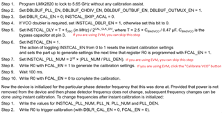

I had an unlock issue with my LMX2820 EVM.
I had the same problem as the questioner (1)-(3) in the link below.
https://e2e.ti.com/support/clock-timing-group/clock-and-timing/f/clock-timing-forum/1224373/lmx2820-lock-out-issue/4647385?tisearch=e2e-sitesearch&keymatch=LMX2820#4647385
I tried the simplified instant calibration procedure mentioned at the end, but no change.
Could you tell me how to resolve this?

  • Hi Osamu,
    When you followed the instant calibration procedure, are you getting the lock detect at Step 1 before initializing the Instant cal?
    If yes, after performing the sequence, are you getting the lock detect status at Step 8? If yes, then the instant cal procedure is done after Step 10 and you can write the settings for new frequency change.
    Thanks!
    Ajeet Pal
  • Hi Ajeet,
    Thank you for your reply.
    Does "the instant calibration procedure" refer to pages 26-27 of datasheet REV.C?
    Also, does step10 mean the last step 2?
    Osamu Wada
  • Hi Osamu,
    The given procedure in the above thread is the updated one from datasheet procedure (it is in progress to update in datasheet) and when you follow the same, PLL should lock the output at 5.65GHz in Step 1 and after performing the Instant cal procedure, the LUT generates at Step 10 with lock detect at 5.65GHz output frequency.
    The last 2 steps are for the new frequency generation.

  • Hi Ajeet,
    In step 1, before initializing instant cal, rb_LD="unlock".

  • Hi Noel,
    After step1 finished, PLL locked to 5650.0124MHz. It worked fine until step10.
    However, when the phase detector frequency was changed to 68.9146MHz and the PLL frequency was set to 5650.9MHz in steps 1 and 2 after initialization, the PLL did not lock.
  • Wada-san,
    The instant calibration settings only apply to the phase detector frequency used to generate them. So if you generate the instant calibration table in with one phase detector frequency, but then change the phase detector frequency, it will not work.

  • Hi Wada-san,
    I confirmed that after instant calibration is complete (Step 1 to 10), we need to keep the same fpd afterward. That means, after Step 1 to 10, when we are going to change the output frequency, we must keep fpd the same value that we used during instant calibration.
