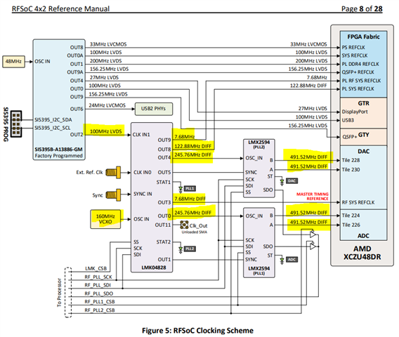

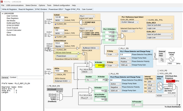

I am trying to insert pl sysref and sysref signals according to my design at vivado in order to achieve MTS.
Somehow I suspect that I am missing here something with the setup of my clocks.
I am attaching the hex of the registers exported from tics pro, as well as the reference manual of the RFSoC4x2, if it would help.
I am pretty new to clock and timing issues, I would appreciate any directions for help for my goal

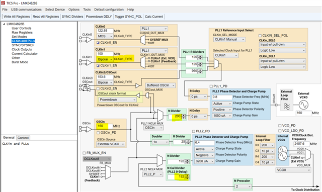

  • Hi Ido,
    While considering the below clocking scheme, the VCXO frequency is 160MHz and to keep the PLL1 lock, PLL1_N divider value should be 200, instead of 2000.
    After changing the PLL1_N value to "200", the PLL1 will lock with 160MHz VCXO. Also keep the CLKin1_TYPE as "Bipolar" for LVDS input, PLL2_N_CAL value same as PLL2_N "192"
    Below are the updated config files for LMK04828 and LMX2594 FYR.
