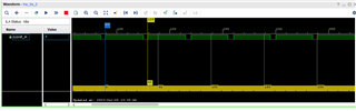

I am using one of the outputs of SDCLKout of LMK04828 as sysref signal at 3.125MHz, however the sysref signal that I get has a duty cycle of 90%. Is it normal? How can I switch the polarity of this signal?
  • Do you have the SYNC_DISSYSREF bit cleared? The signal from the SYSREF divider shares a common internal routing with the signal from the SYNC system (we refer to it as the SYNC/SYSREF distribution path), so it's possible the SYSREF divider is accidentally resetting itself which could have an effect on the duty cycle. The SYNC_DISx bits gate the signal from the SYNC/SYSREF distribution path: when the SYNC_DISx bits are set to 1, the dividers will not be reset by a logic high signal on the SYNC/SYSREF distribution path. Likewise when the SYNC_DISx bits are cleared to 0, the dividers will be reset by any logic high signal on the SYNC/SYSREF distribution path (which can include the SYSREF divider - leading to some strange behavior).

  • Actually I am following the steps given in the "setup of sysref example" on page 40 of the datasheet. Thus yes I clear SYNC_DISSYSREF(0x144). The only difference between what I am doing regarding the example is that I use continous sysref at the end. How I program critical registers regarding the sysref/sync signals is given as follows:
    x"143" --> x"91" sync mode is set to 1; sync_en is set to 1; sysref_clr bit is set to 1
    x"144" --> x"00" sync_dissysref and all sync_disx bits are cleared
    x"139" --> x"00" sysref_mux is set to normal sync
    x"143" --> x"B1" sync_pol is toggled
    x"143" --> x"91" syc_pol is toggled
    x"144" --> x"FF" sync_dissysref and all sync_disx bits are asserted
    x"143" --> x"12" sysref_clr bit is cleared to 0 and sync_mode is set to 2(it doesnt matter which mode it is though, since we are using continous sysref)
    x"139" --> x"03" sysref_mux is set to continous mode
    What I get at the end as sysref signal is given below. Note that I monitor sysref signal in the FPGA and even before LMK is programmed I get a logic high for sysref.
  • Interesting. Your procedure looks correct. Do you have the SYSREF_DDLY or the SYSREF_DIV programmed to a value < 8? Otherwise, can I just get the register programming sequence you're using? I can test this out on my own board and try to replicate the issue.
    Incidentally, I just noticed you asked about the polarity of the signal - if you set the SDCLKoutY_POL bit, that should invert the polarity.
    I am sending the register values that I use in the attachement. I have couple points to make though. I set the SYSREF_DDLY to be 8 since according to Eq-1 and Eq-2 on page 45 of the datasheet I get:
    DELAY_dclk=5+5= 10 VCO cycles(VCO runs at 3GHz)
    DELAY_sdclk= 8+0+2+0=10
    SYSREF_DIV is set to be x"03c0"= 960 %4=0 Thus SYSREF_DIV_ADJUST=2
    and
    Since DCLKoutX_MUX=0 then DCLKoutX_MUX_ADJUST=0
    Is above calculation correct? I am getting perfectly aligned device clk and sysref right?
    By the way since I am not using SDCLKoutY as device clock output i.e., SDCLKoutY_MUX is set to 1(SYSREF as output) changing polarity the way you described does not work right?
    Thanks for your help.
