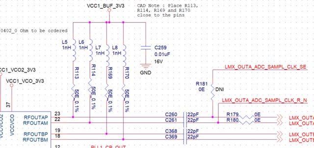

    I want to provide pull_up for RF_OUTA and RF_OUTB. Since i have provided inductor pull-up kindly confirm whether the denoted set up is correct to match 50 ohm impedance as well
  • Hi Aishwarya,
    This pull up works, you may need to tweak the inductor value to optimize output power.
    Depending on you pcb layout, you may need more Vcc bypass capacitors, in the schematic, you only have one (C259).
