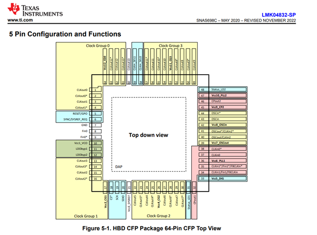

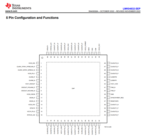

The pinout of the LMK04832-SEP seems to be 180 degrees rotated from the pinout of the LMK04832-SP - please confirm this is correct
Example, pin1 for the -SP part is CLKout0, it is pin 33 on the -SEP version.
