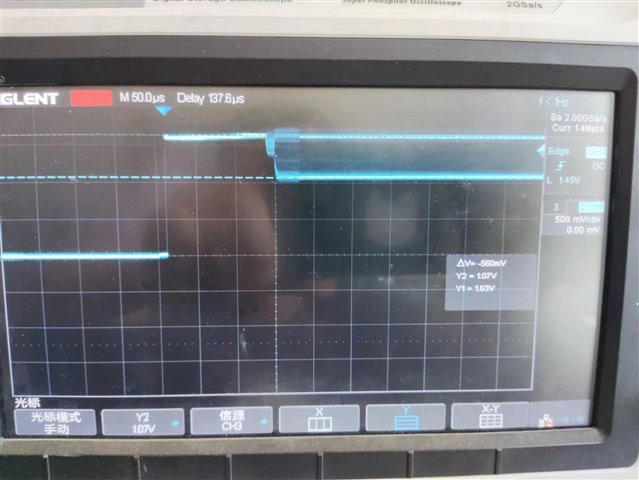

800M input, 200M and 5M output, no output is tested at this time. The 1-M square wave signal is given by the FPGA at sync. The customer want to use a divide to achieve 8 pulse output, but the current configuration can only test one low signal.
Could you help check the above configuration? And how to implement pulse output?

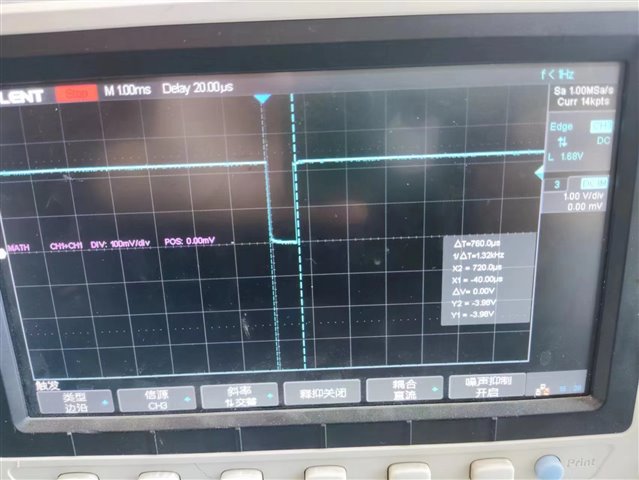

2) The pulse signal can be output using the internal VCO, and the output waveform is as follows:
The amplitude of the waveform has a larger ringing and the signal amplitude is smaller. Why's this?

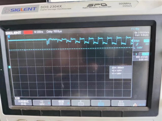

3) In SYSREF continuous output mode, all registers are configured and after 2 seconds are output, directly by configuring 0x013621→0x013620. The output goes from off (PD) to on. The test results are as follows, and the output is a little strange:
Could you help check this case? Thanks.

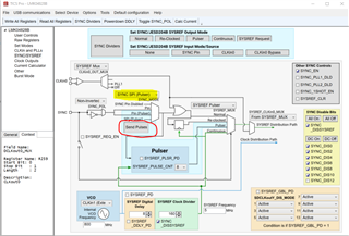

    From your configuration file, SYSREF (5MHz) is set in SPI controlled SYSREF pulse generation. So to have 8pulses SYSREF output, you need to write, R318 [03] to generate SYSREF pulses.
    For pulsed output, make sure the channels outputs are DC coupled so there is RC delay for outputs.
    The device clock out (200MHz), will be continuous outputs for enabled channels.
    For the ringing, if you are taking single ended output, make sure complementary output pins should be 50ohm terminated for any reflection issue.
    Is there output pins external pulled up/pulled low? There seems to be output is settled at low voltage and once pulses are enabled, the output is going to set at defined output format logic levels (LVDA/LVPECL/etc..)
    Please make sure the output termination resistor values for the LVPECL output on board (config file set for LVPECL 2.0Vpp setting).
    Output swing and VOH seems to be low at the outputs.
