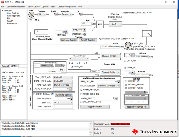

Hi team,
When the denominator is used to its maximum, there are spurs at many frequency points. But some of the frequency points have no spurs. How to avoid fractional spurs by changing the denominator?
Could you help check this case? Thanks.

  • Cherry,
    This spur looks very close to 109/125.  With Fpd=100MHz, this would generate spurs at 100/125 = 0.8 MHz increments and no sub-fractional spurs.
    However, expressing this as a larger unequivalent fraction would just make spurs worse.
    What you are seeing is that the impact of using these larger unequivalent fractions.
    Think of it this way:
    Period of phase detector  = 1/100 MHz = 10 ns
    Fractional Denominator:  4294967295
    Note that this is divisible by 3, so fractional sequence length is:
    1st & 2nd order Modulator:  4294967295
    3rd & 4th Order Modulator:  4294967295 x 3
    You have the 3rd order modulator, so the repeat length of this sequence is:
    4294967295 x 3 x 10 ns = 128 seconds
    In other words, you can see it.  You can reduce the modulator order to 2nd order and you will see it goes 3x faster.
    Also, if you were to choose a different denominator that was not divisible by 2 or 3, it would also be 3x faster, i.e. you can try 4294967293
    But unless you really need this fractional resolution, I would consider expressing the fraction in simpler terms.
    Also, PLLatinum sim tool at ti.com/tool/PLLATINUMSIM-SW models spurs.  In this case, you would model as a fraction of 1/5 and say 100% randominzation.
    Dean

  • Cherry,
    1)  For large denominators that do not reduce, these "runaway spurs" will exist.  This is because the repeat length of the sequence is so long that you can visually see it.  So so this is a consideration when creating large denominators ( like 1000000/4000001 instead of 1/4) when then are not necessary bring this on.  For example, in the above example, you have the fraction of 3745211481 / 4294967295 to get an output of 10187.1999999994.  But is this what you really want, or do you really want 109/125, which would give an output of 10187.2  .  The fraction of 109/125 would have way better spurs in all regards.
    Your fraction is about 1/5, which is pretty reasonable.  If it was close to 0, 1, or 1/2 the spurs might get worse
    2)  Aside from not using larger fractions, I do think the choice of fraction might have an impact as well.  If you want large fractions you might also try not using the entire numerator, suppose you choose a fractional denominator of 100000000 or 10000001, this would have a much faster repeat rate.
    Realize that even for a fraction like 17/100, there is actually a walking spur, but because the spur is walking so fast, the loop filter can track it out.  It is only in this case where the spur frequency is low that you see the walking spur.

  • For the 4th order modulator, the minimum N divide is 40.  So for VCO frequencies below 8 GHz, it violates this constraint.  So this is perhaps the issue with the locking.  For lower order modulators, the minimum N divide is lower.
    Higher phase detector frequency will push out the MASH energy to higher frequencies, so is generally beneficial.
    Also, realize that if you increase the phase detector from 100 MHz to 200 MHz, this alters the loop bandwidth, unless the loop filter components are changed.  To preserve the same loop bandwidth without changing the loop filter, you can simultaneously decrease the charge pump gain by 50% to keep the same loop bandwidth and phase margin.
