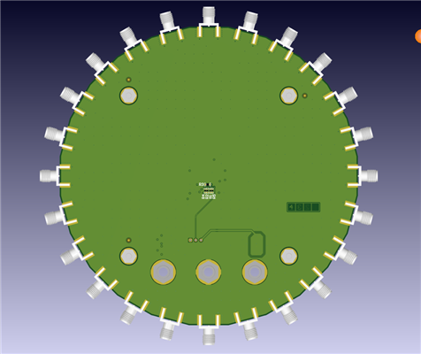

3) is there a photo that shows the back side of the evaluation module (Website shows only from view). Not looking for a professional photo, Any photo, maybe from some engineering lab using this evaluation module will do.
    I can find an EVM and send a picture to you.

    Below is a backside picture of EVM.
    Asim
