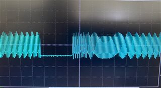

I configured a 10 MHz output :
Observing the waveform :
Question : The 10 MHz is correct, but the waveform is gated in period of around 0.5 second ( muted around 0.2 second ) ? How can I get a ontinuous output ? Thanks.

       The scope shot is the waveform of CH6 OUT6_P, OUT6_N is floating.  1V/DIV and 50ms/DIV.
       If zoom in with 100ns/DIV, it is a 10MHz sine wave. The problem is : there is a muted period for every ~0.5 second shown is the middle of scope shot.

      3. The muted period show up both before and after programming with I2C. If I don't progrm, the muted period still shows up. It is quite interesting because I never program the EEPROM. The EEPROM is empty, If I don't program, how are the register values loaded ? (HW_SW_CTRL=1)
      4. Soft-reset or power cycle does not prevent the coutinuous muted period showing up.
    Martin

    => The "stable waveform" means that muted period appears stably and looks like an intentional behavior.
    Is it possible that some event causes LMK05318 mute output and reboot ?
    Martin
  • Jennifer,
       Above problem is has been fixed. It is cuased by a firmware bug : the MCU watchdog timer was enabled incidentally.
